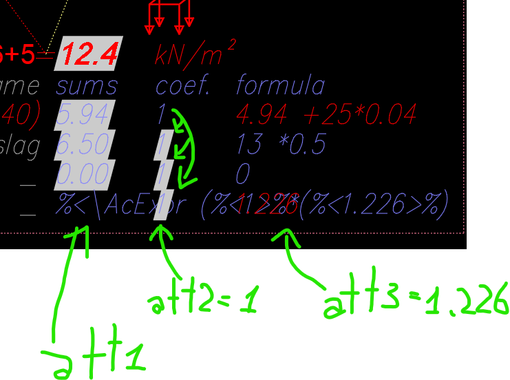

Hi. Can you please explain how you solved the issue?
I am struggling now with following task:
att1 has to be a result of formula expression, calculated via att2 *att3.
And can't get it right.
So far, instead of a number (result of att2 *att3), I get a string:
"%<\AcExpr (%<att2>%*(%<att3>%)"
where att2 and att3 are correct values of respective attributes.
Please see the snapshot.

The code above is almost good.
Had a problem with parantheses.
Below, a working code:
