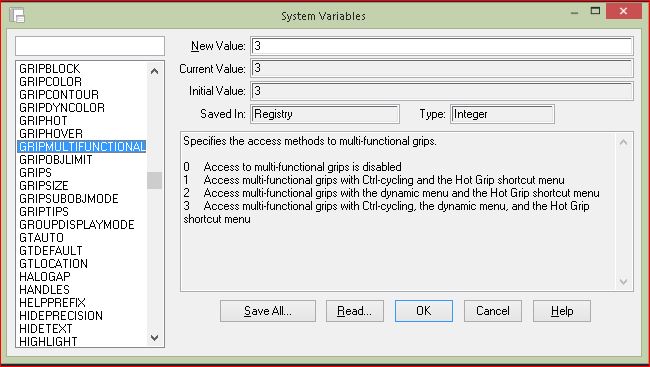

You need to enable the GRIPS multi functions.
That functionality can also be found in OPTIONS, on the Display tab, in the GRIPS selection box, but when you see it described in the SYSVDLG, it is easier to figure out how they all work together. When in doubt, check SYSVDLG out, plenty to be learned there.
Glad I could help, now get back to work! :beer:

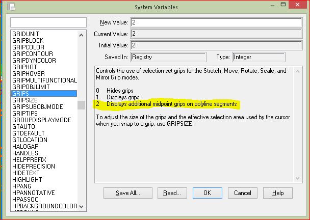

Another important one is shown in the screenshot, 2 is the default, but I would really miss those midpoint grips if they were not there, or got changed by a lisp or something.
