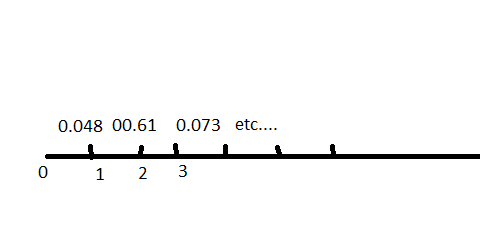

I have this CSV and i need to plot in an horizontal line, a marker (numbered) at the distance from zero specified in this spreadsheet:
from the example, "1" at 0.048 from Zero, "2" at 0.061 ....
please see the examples.
any idea?
many thanks!

Just a simple column answer using contactenate
just paste this into column E =CONCATENATE("LINE ",C1,",","0 ",C1,",",1, ) this will draw line 1 unit high. Just copy and paste the E column to Autocad command line.
