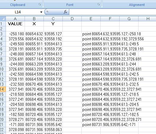

gedu Posted July 20, 2016 Posted July 20, 2016 (edited) Existe algun programa lisp ó desde el mismo CAD algun comando con el que pueda insertar un listado como el que adjunto en excel? Adjunto el listado y el CAD con esos puntos ya insertados como ejemplo terminado. Gracias. Any exist lisp program or from the same CAD any command which can insert a list like that it attached in excel? Deputy listing and CAD with those points already inserted as a completed example. Thanks. Textos a insertar en CAD.xls Textos a insertados en CAD.dwg Edited July 21, 2016 by SLW210 Translated to English Quote

gedu Posted July 20, 2016 Author Posted July 20, 2016 (edited) Modifiqué el excel incorporando el "z" y separando el x e y en columnas independientes, pero al colocarle 3 decimales no los representa. Habría alguna forma de rectificar este problema? Gracias. I modified the excel incorporating the \"z\" and separating the x e and in separate columns, but to put him 3 decimal places does not represent them. " Would there be any way to rectify this problem? Thanks. Edited July 21, 2016 by SLW210 Translated to English Quote
BIGAL Posted July 21, 2016 Posted July 21, 2016 (edited) In english sorry a diferent way, Remark snuck in at same time. Copy and paste column E to Autocad command line change the "Point" to =CONCATENATE("text ",B3,",",C3," "," "," ",A3) Edited July 22, 2016 by BIGAL Quote
