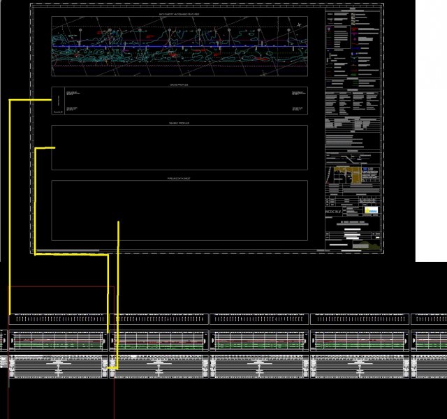

I have to set up a series of charts where the legend and other fixed items have to be in paper space, while the data in model space. I will then viewport the data to the paper space.
Now, I'm getting a bit confused about the paper space, because something is not right: I have this attached MASTER.dwg it will represent the name of the official chart, it's a blank dwg, because they want to have a blank master drawing and everything else xreffed.
then I have this LEGEND.dwg which needs to be on paper space. from this legend in paper space we will have to create viewports on model space, where we will xref various data.
I'm having some troubles first of all in xreffing with relative path the legend to the master, it says -relative path cannot be assigned - and yes, I've already saved the master drawing, closed and reopened everything, and still I can't xref relative path.

Second issue... how can I xref this legend in paper space? I'm confused, as i know that in general you always xref in model space.

See, our project is organized the way i showed in the photo at the beginning of this thread, they want the title block in paper space with viewport on model space where i'll xref the data (xref from modelspace)
Step by step, I did exaclty what i mentioned earlier: I have open the MASTER.dwg and I want to xref the LEGEND from the master paper space, relative path. nothing more
