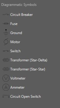

I need to do several line diagrams of electricity, but in autocad mep, there are only very few elements to make a single-line diagram of electricity.
Attached a picture of the blocks on mep.

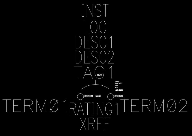

Examples of blocks found in AutoCAD electrical...
Each block has a number of different attributes. For example, the circuit breaker block has 18 attributes.
