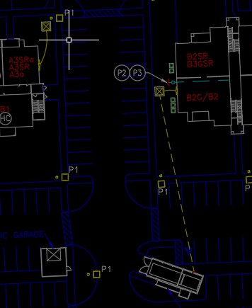

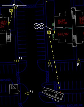

drewbranson10 Posted July 27, 2016 Author Posted July 27, 2016 Alright, I have attached two screenshots into the post, one shows the file itself, the other shows it after being xref'd into a sheet. What we are doing is we have the base at full size which we are referencing into a sheet and it is scaled down to fit on it. The only thing I can think of that may be messing it up is the fact that the xref is scaled down, but I would think if that is the reason than everything would look continuous but it is only the arcs. Quote

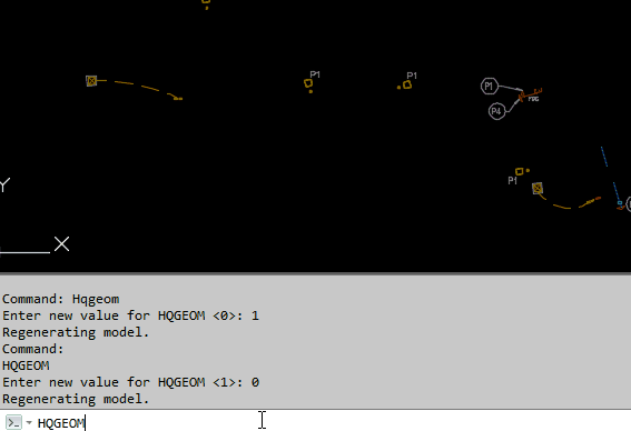

rkmcswain Posted July 27, 2016 Posted July 27, 2016 Hello, I have noticed that in AutoCAD 2017 whenever I make an arc that is dashed in a file and then xref it into another dwg it shows up as a continuous linetype. Turn Hardware Acceleration OFF, or just turn off "High Quality Geometry". Either will 'fix' the problem. Re: https://knowledge.autodesk.com/support/autocad/troubleshooting/caas/sfdcarticles/sfdcarticles/Linetypes-appear-incorrectly-in-AutoCAD.html?v=2017 Quote
drewbranson10 Posted July 27, 2016 Author Posted July 27, 2016 Awesome! That did the trick, thank you for the help. Quote
