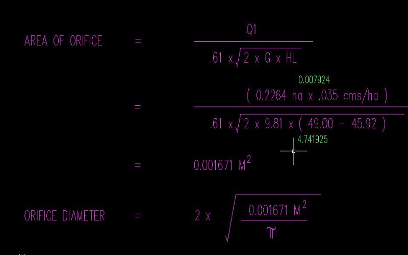

JONTHEPOPE Posted January 7, 2009 Posted January 7, 2009 Could some one help me with calculation for lips routine here's what i've got so far any help will be great. I tried to break down formula as much as i could to make it easy for programming. area of orifice.lsp Quote
David Bethel Posted January 7, 2009 Posted January 7, 2009 I don't that I grasp the entire process, but here is a better starting point: [b][color=BLACK]([/color][/b]defun c:orifice [b][color=FUCHSIA]([/color][/b]/ q1 hl g oa od[b][color=FUCHSIA])[/color][/b] [b][color=FUCHSIA]([/color][/b]initget 7[b][color=FUCHSIA])[/color][/b] [b][color=FUCHSIA]([/color][/b]setq q1 [b][color=NAVY]([/color][/b]getreal [color=#2f4f4f]"\nQ1 Data: "[/color][b][color=NAVY])[/color][/b][b][color=FUCHSIA])[/color][/b] [b][color=FUCHSIA]([/color][/b]initget 7[b][color=FUCHSIA])[/color][/b] [b][color=FUCHSIA]([/color][/b]setq hl [b][color=NAVY]([/color][/b]getreal [color=#2f4f4f]"\nHL Data: "[/color][b][color=NAVY])[/color][/b][b][color=FUCHSIA])[/color][/b] [b][color=FUCHSIA]([/color][/b]initget 7[b][color=FUCHSIA])[/color][/b] [b][color=FUCHSIA]([/color][/b]setq g [b][color=NAVY]([/color][/b]getreal [color=#2f4f4f]"\nG Data: "[/color][b][color=NAVY])[/color][/b][b][color=FUCHSIA])[/color][/b] [color=#8b4513];;;ORIFICE AREA[/color] [b][color=FUCHSIA]([/color][/b]setq oa [b][color=NAVY]([/color][/b]/ q1 [b][color=MAROON]([/color][/b]* 0.61 [b][color=GREEN]([/color][/b]sqrt [b][color=BLUE]([/color][/b]* 2 g hl[b][color=BLUE])[/color][/b][b][color=GREEN])[/color][/b][b][color=MAROON])[/color][/b][b][color=NAVY])[/color][/b][b][color=FUCHSIA])[/color][/b] [color=#8b4513];;;;I DONT UNDERSTAND THE MIDDLE 2 STATEMENTS[/color] [color=#8b4513];;;ORIFICE DIAMETER[/color] [b][color=FUCHSIA]([/color][/b]setq od [b][color=NAVY]([/color][/b]* 2 [b][color=MAROON]([/color][/b]sqrt [b][color=GREEN]([/color][/b]/ 0.001671 pi[b][color=GREEN])[/color][/b][b][color=MAROON])[/color][/b][b][color=NAVY])[/color][/b][b][color=FUCHSIA])[/color][/b] [b][color=FUCHSIA]([/color][/b]prin1[b][color=FUCHSIA])[/color][/b][b][color=BLACK])[/color][/b] -David Quote

JONTHEPOPE Posted January 7, 2009 Author Posted January 7, 2009 looks good thanks real clean. this, language can really work huh . this will help development for sure. i enjoy lisp but am not sure how to use vbaide. thanks again Quote
David Bethel Posted January 8, 2009 Posted January 8, 2009 Lee, 1 (bit 0) Prevents the user from responding to the request by entering only ENTER. 2 (bit 1) Prevents the user from responding to the request by entering zero. 4 (bit 2) Prevents the user from responding to the request by entering a negative value. 1 + 2 + 4 = 7 It forces a positive numeric input. -David Quote
Lee Mac Posted January 8, 2009 Posted January 8, 2009 Thanks David for your info, I have improved on your routine slightly: (hopefully this is what JON is after!) (defun c:orifice (/ g q1 hl oa od) (or g (setq g 9.81)) (initget 7) (setq q1 (getreal "\nQ1 Data: ")) (initget 7) (setq hl (getreal "\nHL Data: ")) (initget 6) (or (setq g (getreal (strcat "\nG Data <" (rtos g) "> : "))) (setq g 9.81) ) ;_ end or (setq oa (/ q1 (* 0.61 (sqrt (* 2 g hl))))) (setq od (* 2 (sqrt (/ oa pi)))) (princ (strcat "Orifice Area: " (rtos oa) "\nOrifice Diameter: " (rtos od) ) ;_ end strcat ) ;_ end princ (prin1) ) ;_ end defun Quote
