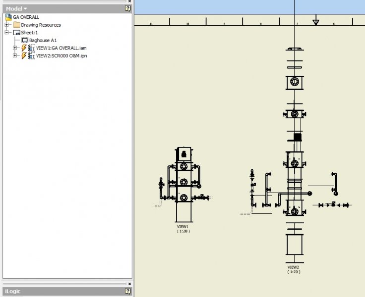

Lewis C Posted August 4, 2016 Posted August 4, 2016 Hello there, Is it possible to produce an exploded view in an .idw file? I need to produce the front, side and top views of a product in the same drawing file but not exploded - only a visual exploded representation view in the corner of the drawing is required. Any help would be much appreciated! Lewis Quote

Lewis C Posted August 4, 2016 Author Posted August 4, 2016 Thanks for the replies, unfortunately ReMark's link is not what I am after; I know how to produce an exploded assembly, I was just wondering if it was possible to have just a single isolated exploded view in a drawing without the other views being exploded also. I could produce a separate exploded assembly and import that as another base view in the same drawing, but that means two .iam files are needed (one exploded and one not). The trouble is I need to produce 35 different drawing files, so would double the amount of .iam files needed and a lot of work... surely there's an easier way? Quote

czc Posted August 4, 2016 Posted August 4, 2016 I do exploded views in .ipn files. Then you can place your unexploded .iam views and the exploded .ipn view. Quote
Lewis C Posted August 4, 2016 Author Posted August 4, 2016 I never thought of that! Is there a benefit of doing it in an .ipt file rather than an .iam file? Quote
Lewis C Posted August 4, 2016 Author Posted August 4, 2016 Sorry, I meant .ipn... but yes, that exploded view alongside the non exploded view is exactly what I'm after. Just out of curiosity, why do you create the exploded assembly in an .ipn rather than an .iam file? Quote
czc Posted August 4, 2016 Posted August 4, 2016 Sorry, I meant .ipn... but yes, that exploded view alongside the non exploded view is exactly what I'm after. Just out of curiosity, why do you create the exploded assembly in an .ipn rather than an .iam file? When I started using inventor thats what I thought the ipn files where for. You basically just put your assembly in the ipn anyway. Quote
