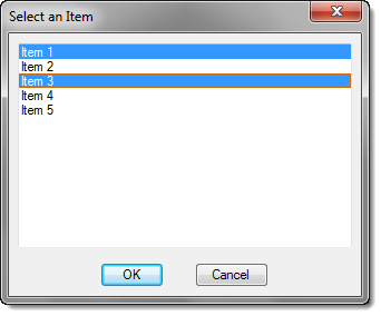

Question is : If this xref has unload . I can't see this xref in drawing. So, How do I do “Select objects on the reference file” ?
I think need a dialog show unload reference file list , select item reload from dialog.
I think can use Lee's listbox function to do. Who can help me? Thanks a million.
How get the unload xref list ?

Another, using Vanilla:
(defun unloadedxrefs ( / r x )
   (while (setq x (tblnext "block" (not x)))
       (if (= 4 (logand (cdr (assoc 70 x)) 36))
           (setq r (cons (cdr (assoc 2 x)) r))
   (reverse r)
_$ (unloadedxrefs)
("xref")

Lee, Thank you very much! gooooooooood!!! :D
like this ? :lol:
(defun c:xr ( )
(if (unloadedxrefs)
		(foreach x (LM:listbox "Select reference file to be Reloaded" (unloadedxrefs) 1)
			(command "-xref" "R" x)
		(prompt "\nFiles have been Reloaded:")
	(prompt "\nNo reference file need reload.")
Edited by DuanJinHui

Yes, that would work - you could improve the efficiency slightly by storing the list of unloaded xrefs using a local variable, e.g.:
(defun c:xr ( / lst )
   (if (setq lst (unloadedxrefs))
           (foreach x (LM:listbox "Select reference file to be Reloaded" lst 1)
