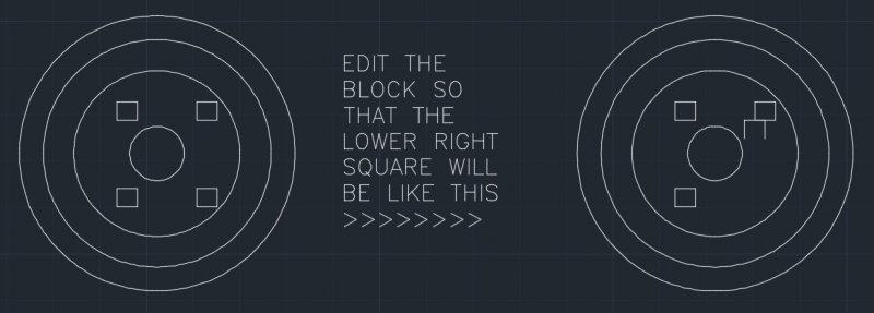

ctrlaltdel Posted August 20, 2016 Author Posted August 20, 2016 pBe Sir, I amended the code but when LISP loaded error came out (defun c:klmgagidgiASDFJNSAASDFJKASNDLFVASD LFDSAHFSDFVANDGNAQ-!_MyBlock76fafkljgb asrfgquyrwegf wqeiugf (/ adoc nb ent entV);<-- Name of the deepest block Cannot invoke (command) from *error* without prior call to (*push-error-using-command*).Converting (command) calls to (command-s) is recommended. Anyway my last try to explain what my work entails Attached is a simplified drawing. All are blocks. The 4 square share the same block name but are nested in different block. I need to - get into the correct block level - explode lower right square block - move the lower right side square just below the upper right square - delete the lower entity of the square as per in the photo *All blocks still need to remain as per their original block integrity except 1 of the square block that was exploded I have tried -refedit in the above drawing for at least 30 minutes but still unable to go to the right block level to do the above. That is why I would be glad for a LISP that can get me straight into the correct block level. Thanks HOW TO ACCESS THE NESTED BLOCK PART 2.dwg Quote

ctrlaltdel Posted August 20, 2016 Author Posted August 20, 2016 See: https://www.theswamp.org/index.php?topic=51887.msg569257#msg569257 Thanks Lee Mac. Close but I need to be in the "Block in-place"/refedit edit mode cause I need to see All the other block as a reference for me. I hope you know what I am getting at & have a solution? Crossing Fingers. Quote
ctrlaltdel Posted September 2, 2016 Author Posted September 2, 2016 I amended the code in this manner (defun c:myblockedit ( / lst ) (if (setq lst (cadddr (nentsel))) (command "[b]_.refedit[/b]" (cdr (assoc 2 (entget (cond ((cadr lst)) ((car lst))))))) ) (princ) ) But encounter this error after clicking the entity Command: MYBLOCKEDIT Select object: _.refedit Select reference: 5 Reference not found How to make it work correctly? Quote
