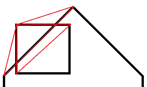

I am trying to measure the gable face of a dormer that I have crudely drawn for measurement purposes.
Could anyone please suggest I can successfully achieve a measure of this, i.e. the area demarcated by the red "A"?

I run into issues like this occasionally, The easiest way I've found is to not get fancy with it and just change the view so the face you marked A is on the XY plane. Then trace a 2D polyline over each edge snapping where you can. This will create a triangle of you can snap to easily for measurements since all the points of the polyline will be coplanar. Don't have a copy of AutoCAD at home but I made a quick sketch in Paint to illustrate.
I have revisited this and now am able to snap to a 3D vertex which is satisfying my requirements. The measurement looks good when I change the angle at which I am viewing the roof.
