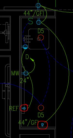

ReMark Posted August 19, 2016 Posted August 19, 2016 Well for starters the geometry in model space is drawn at full size which is the correct way to do it if layout will be utilized. It was NOT drawn "to scale" as one might do manually on a drafting board. The one viewport over in the layout has been assigned a scale of 3/8"=1'-0" and the viewport display is locked which too is the proper way of doing things. Yes, the electrical symbols in model space appear overly large. Maybe that was done on purpose? Anyway, if you click on the block in model space then execute the BEDIT command you can edit any of the objects in the block editor. When done save the edits before leaving the block editor. I tried reducing the scale of the GFI symbol by half and it worked. Quote
ReMark Posted August 19, 2016 Posted August 19, 2016 Just to show you the block can be edited and the symbols resized. Note the size of the two GFI's circled in red compared to the others. Quote

rkent Posted August 19, 2016 Posted August 19, 2016 When in MS simply set the annotation scale to 3/8", no need to edit anything. I might suggest using maxvp to go into the viewport, you will be in MS but you will be in the scale of the viewport each time so you don't have to keep changing anno scale if there are other scales being used in the drawing. MaxVP - either use the icon down near the lower right, or just double click on the viewport frame, to come back just double click on the wide blue border around the edge of the screen. Quote
Dana W Posted August 19, 2016 Posted August 19, 2016 When in MS simply set the annotation scale to 3/8", no need to edit anything. I might suggest using maxvp to go into the viewport, you will be in MS but you will be in the scale of the viewport each time so you don't have to keep changing anno scale if there are other scales being used in the drawing. MaxVP - either use the icon down near the lower right, or just double click on the viewport frame, to come back just double click on the wide blue border around the edge of the screen.+1 on this. The symbols are annotative. Leave them be. Quote
