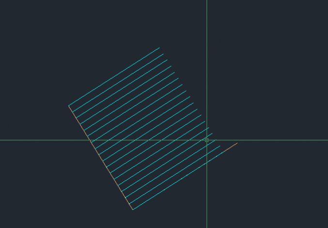

I've got another Idea, maybe this is the best I've ever had!
Create a custom quote, which looks exactly as the original.
1. I track a line
2. a lisp dumps the objects that intersect that line
3. In each point it insert the arrow (to looks as the original)
4. it counts all these intersection points
5. it gets the number of the bar from the xdata (I have to save somewhere what that number is.. phi 12, phi 20 and his length)
6. the lisp writes the correct value of everything!
7. I will add something that refresh these quotes, if something change.. (maybe a reactor)
Looks possible?

I've done some work in the freetime..
(thanks to Mr Lee for the functions I've found in his site)
(defun c:test ( / e i n s x )
(setq int_list nil)
(setq ptlist (list (getpoint) (getpoint)))
(vl-cmdf "_line" (car ptlist) (cadr ptlist) "")
(setq pline (cdr (assoc -1 (entget (entlast)))))
   (if (setq s (ssget "_F" ptlist '((0 . "LINE"))))
           (setq i 0
                 n (sslength s)
           (while (< i n)
               (setq e (ssname s i)
                     x (cdr (assoc 0 (entget e)))
                     i (1+ i)
               ;(print x)
             (setq int (car (LM:intersections (vlax-ename->vla-object pline) (vlax-ename->vla-object e) acextendnone)))
             (vl-cmdf "_-insert" "aca_freccia" int 0.1 0.1 (* 180 (/ (angle (car ptlist) (cadr ptlist))) pi))
             (setq int_list (append int_list int))
(defun LM:intersections ( ob1 ob2 mod / lst rtn )
   (setq lst (vlax-invoke ob1 'intersectwith ob2 mod))
   (repeat (/ (length lst) 3)
       (setq rtn (cons (list (car lst) (cadr lst) (caddr lst)) rtn)
             lst (cdddr lst)
   (reverse rtn)
in the gif you can see the original behavior and then my lisp.. I don't know why the orientation of arrows is wrong..
( don't know why but the gif doesn't start.. I've uploaded here too:https://giphy.com/gifs/3o7TKtXBWc4vnFGrPq)
I'll continue tomorrow, if you have other advices I'll be happy to read them :)
By using the Fence selection mode, the points of intersection are actually already available:

Wow Mr.Lee, that code looks very professional compared to mine!
I'll use it as a start point!
The changes I'll try to do are:
-ask for the type of bar to quote (just select one of them: there is an Xdata with the number)
-create a polyline instead of a line and trim it at the last bar
-rotate by 180degree the blocks
This will be the first step :) thanks
