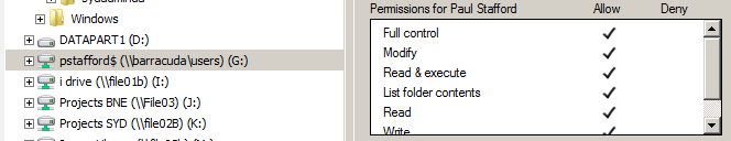

I have full control permissions on the home drive. Is there something else about the home drive that is stopping the creation of the folders?

What does this return (getenv "Homedrive") for me "c:"
I get "G:" which is where I can see my home drive so assume correct?
Sometimes networks need the \\baracudda\users rather than G:
Play with (vl-mkdir dir) try different options for dir

Thanks Alan. I saw that and typed it in manually - still didn't work. I have a feeling there is something a bit strange with the permissions.
