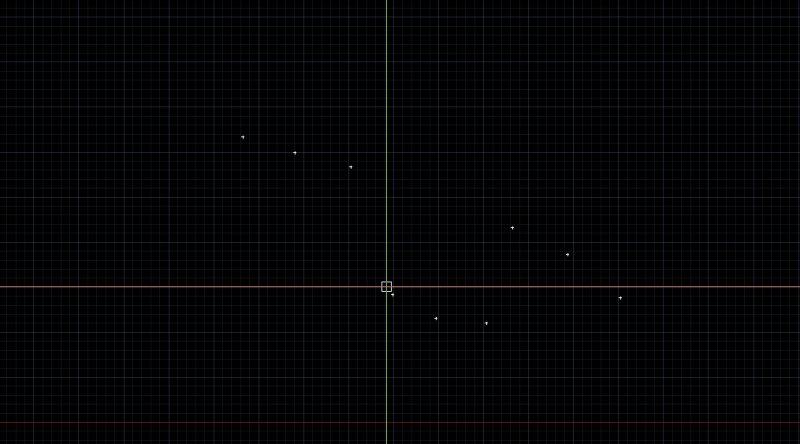

Please see image above iam not creating any point but when iam clicking any where there are points appearing and if i pan the space they disappear. how to get rid of this problem?

That would be blips. They can be turned off with the BLIPMODE variable.
Blipmode is supported in 2012 I think it was 2013+ "Blipmode Bad Command" you have to use (setvar 'blipmode 0)
Thanks a lot BIGAL it worked to get rid of the irritating dots on screen.!

Blipmode can still be enabled or disabled via the keyboard by typing .blipmode and selecting either On/Off. Note the presence of the before the command name.
