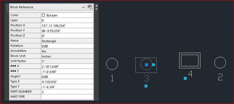

Dadgad
I would probably just tweak them, if need be, in my QUICK PROPERTIES palette. CTRL+SHIFT+P to enable them, or turn them on in your task bar, at the bottom of the screen.
I suspect that Lee's lisp, to which BIGAL alludes, is the following http://www.lee-mac.com/dynamicblockcounter.html , which is very useful if you need to keep track of the conditions of multiple blocks easily.
Thanks Lee! :beer:
Share this post
Link to post
