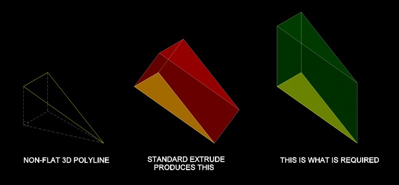

Hi,
Please see image below for example.
I have a non-flat 3d polyline triangle, and I would like to extrude it vertically. Usually (by default) the extrude command will extrude perpendicular to the slope of the triangle, I would like to extrude vertically regardless of the slope.
I am able to achieve this by extruding along a vertical line (path), but have found this does not produce ideal results when extruding multiple triangles at once.
Can anyone recommend a better solution?

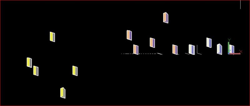

Try using Sweep with a Path, instead. I just created a group of triangles, as shown, and rotated them to different random angles with 3DRotate. I created a 3D Polyline along the Z axis, to use as a path. I then used the Sweep command, selected all of them, then the path, and it seems to have done what you are after.

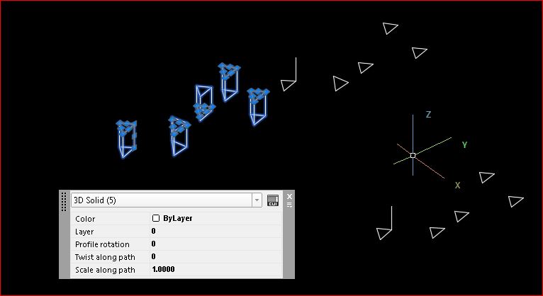

Unfortunately, SWEEP produces similar results to EXTRUDE (when selecting multiple triangles). This issue I have is that when performing a multi-EXTRUDE or multi-SWEEP, the resulting 3D solids are "off" the face of the original triangle (.DWG attached showing examples).
The workaround I have so far is to extrude a small set of triangles, along a Z-path (line), ensuring that each triangle I am extruding has a vertex at the same endpoint of the path/line. So for each set of triangles, they have to all share a common point. Hope that explanation makes sense haha.

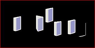

When I Sweep the small varied set of 3D polyline closed triangles, along a single path, which starts at one vertex of one of them, then they seem to generate just fine, at numerous different elevations, the sweep of each starting where they were drawn, as shown in the screenshot.

Please see the attached DWG, and if you wouldn't mind - try SWEEP or EXTRUDE all the triangles (shown white) at once, along the path (shown yellow). I believe you should find that some of the newly created solids will not be aligned correctly with the triangles.
