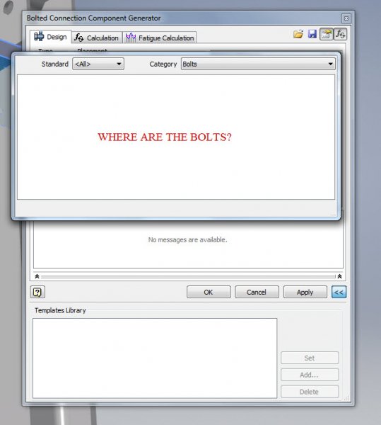

I work with Inventor 2016 and I'm trying to get a bolted connection with the design tab.
The only problem is that my bolts, nuts,... are gone.
What happend and does anybody know the solution?
Thanks!
Multiple things to check here...
1. Were they there at one point and if so when?
2. If not, have you installed the CC.
3. If so, then ensure you have your Application Options set to either Desktop Content or Vault Server depending on your install methods.
4. Ensure your Inventor IPJ has the right CC libraries enabled. There is a little button on the right side of your project editor that will let you configure CC libraries for that project file.
