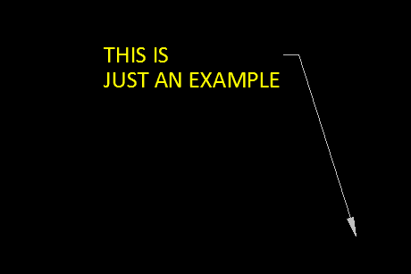

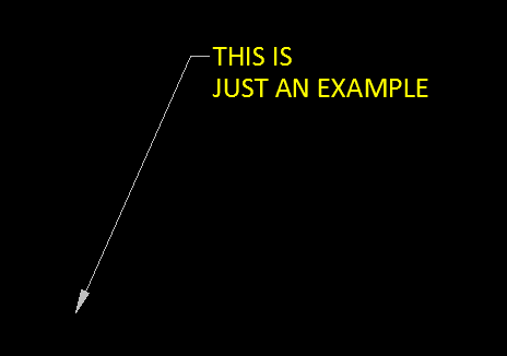

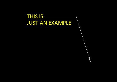

masterfal Posted September 12, 2016 Posted September 12, 2016 Hi All, Just wondering if anyone knows if its possible to fix multileaders so that the 'landing' line can be extended properly? easier to explain with pictures.. see below pic 1 - all good when leader comes from this direction pic 2 - i don't like it like this.. pic 3 - i would like it to be like this if possible Quote

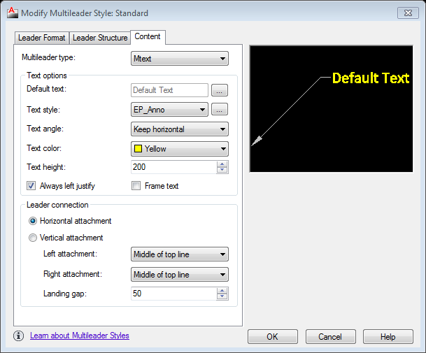

rkent Posted September 12, 2016 Posted September 12, 2016 In the mleader style editor, Content tab, lowest choice shown is 'Extend leader to text', the box is probably blank so pick in that so a check is displayed. Quote
masterfal Posted September 13, 2016 Author Posted September 13, 2016 In the mleader style editor, Content tab, lowest choice shown is 'Extend leader to text', the box is probably blank so pick in that so a check is displayed. damn, i'm using 2011 and it doesn't seem to have that setting to extend leader to text (as per below) i have a copy of 2015 on my macbook and noticed it does have that option. i guess its something they added sometime after 2011 then? Quote
rkent Posted September 13, 2016 Posted September 13, 2016 I forgot to look at the version you are on, yes that option was added not long ago, IIRC. Quote
rkmcswain Posted September 13, 2016 Posted September 13, 2016 I'm pretty sure this was added in 2012. Quote
rkent Posted September 13, 2016 Posted September 13, 2016 I'm pretty sure this was added in 2012. Yep, 2012, good memory there. Quote
masterfal Posted September 14, 2016 Author Posted September 14, 2016 my bad.. oh 2012.. so close! haha oh well. cheers for the info guys Quote
