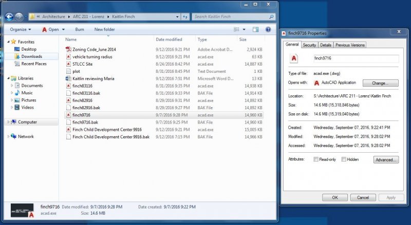

mlstlouis Posted September 14, 2016 Author Posted September 14, 2016 Thanks for the help. Here's a capture with the properties shown for one file. Notice is shows a .exe and .dwg in parenthesis after... Quote
RobDraw Posted September 14, 2016 Posted September 14, 2016 The file extension, in parenthesis, is .dwg. Somehow the type of file has been associated with acad.exe. See if IT can make any sense of that. It is not an AutoCAD issue. Quote
ReMark Posted September 14, 2016 Posted September 14, 2016 Probably a Windows file type association problem. Maybe this will help. http://www.thewindowsclub.com/change-file-associations-windows Quote
RobDraw Posted September 14, 2016 Posted September 14, 2016 That might help, but I don't think so as the file seems to behave normally. Quote
