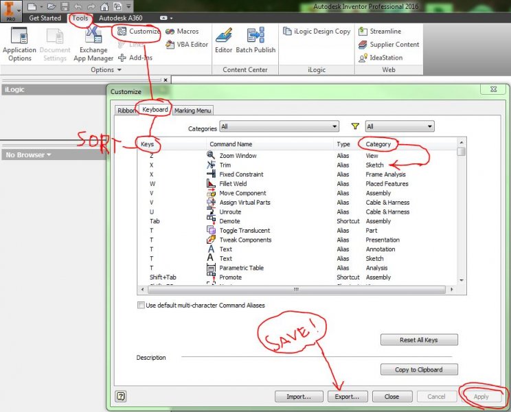

kpyoung333 Posted September 15, 2016 Posted September 15, 2016 Attached is a screenshot of how to setup the keyboard shortcuts. As far as isolines (the number of lines shown to give a 3d representation view), the model shown in "paperspace" (drawing.idw) does not have isolines and the model (part.ipt) is either shaded or wireframe (without isolines). When you say change isolines what do you mean? Screenshots are helpful. Quote

MarkFlayler Posted September 18, 2016 Posted September 18, 2016 That tutorial is clearly not written for Inventor disregard its usage with Inventor. There is no command prompt in Inventor. Locate some new learning resources like these... http://www.infiniteskills.com/training/learning-autodesk-inventor-2017.html http://www.ascented.com/courseware-solutions/autodesk/courseware/autodesk-inventor.aspx Quote
