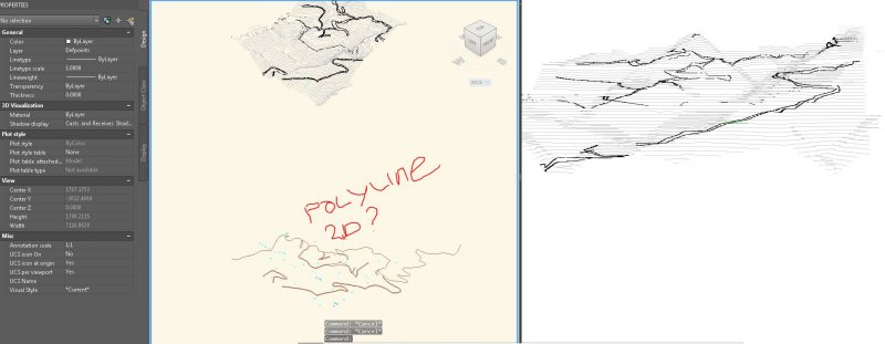

the process im doing is very time consuming.
NOTE:
white polylines have elevations
the brown ones is the road (which i need to draw using lines)
create POINT and snap it to the white polylines to get elevation of the first point
and i create another POINT and snap it to the closest white polyline, to get the next point
then i create LINE, snap it on the 2 POINTS with elevation and DIV aand just make assumptions on how many point i will use
then i off snap. then i move every point to the brown polylines then after that i delete the temporary line i use to DIV the points
then i draw LINES again and snap it to the points i moved on the brown polylines to get the start and end Z...
i will add the map im doing to make it easier to understand...
is there an easier way to create the roads????

I noticed the braun lines (road) is created with a 2d polyline. That's just on z=0.
The vertexes need to have a z, you can do that with 3d polylines.
Extrude the road to intersect with the landscape. etc.
You might as well take a look at the triangulate function.
Get familiar with meshes and modelling solids .;-)
