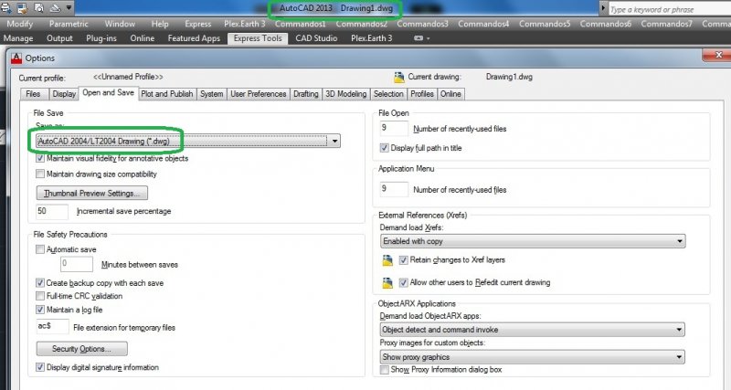

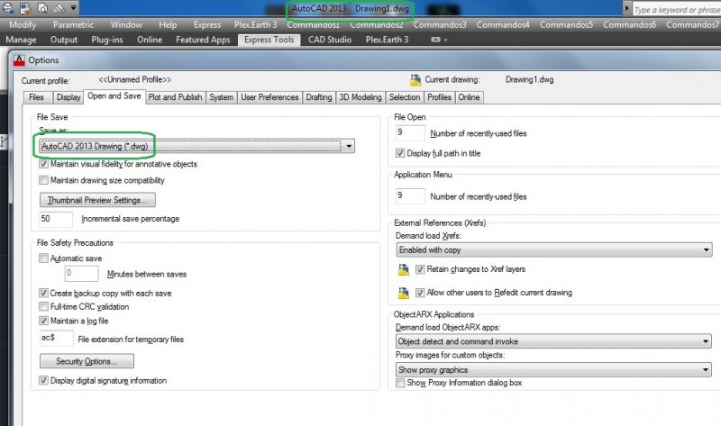

sivapathasunderam Posted September 22, 2016 Posted September 22, 2016 Dear all; I am using AutoCAD 2013, I usually save as with 2013 as shown below image, but other low AutoCAD version people can't open the dwg as per my experience I feel that while saving the file with low version it takes more time to save Option setting with low version as below image what is the differents & benefits of saveas with AutoCAD 2013 version & other different version thanks Siva Quote
rkent Posted September 22, 2016 Posted September 22, 2016 Check the box for Maintain drawing size compatibility and test that. Unrelated comment - conventional wisdom for a while now has been to set Incremental save percentage to 0. That is some legacy carry over from years ago that is not needed now. Not sure why they leave that option in there. Quote
RobDraw Posted September 22, 2016 Posted September 22, 2016 Save as to a lower version is not always the proper way to make your files compatible with previous versions. It does not eliminate or convert newer type objects and options. The proper way to ensure compatibility is to export. Quote
SLW210 Posted September 23, 2016 Posted September 23, 2016 AFAIK, using Export to a .dwg in Vanilla AutoCAD is the similar to using WBLOCK, at least in AutoCAD 2011 and I see no option to save to earlier format. Maybe you meant -EXPORTTOAUTOCAD and AECTOACAD? You can convert several drawings at a time with DWG TrueView and some options on the converting as well. Do you really need to go as far back as 2004 version? Quote
RobDraw Posted September 23, 2016 Posted September 23, 2016 It was intentional to not mention commands and or the procedure. Vertical products can export to vanilla and previous versions. I'm not sure what vanilla CAD is capable of when it comes to export but TrueView will convert files from any of the vertical products as well as from a newer version of vanilla to an older one. Quote
rkent Posted September 23, 2016 Posted September 23, 2016 FWIW - Batch converting can be done in AutoCAD as well using DWGCONVERT command. Quote
SLW210 Posted September 23, 2016 Posted September 23, 2016 DWGCONVERT no such command in Vanilla AutoCAD 2011, I am not sure when that came about. Quote
rkent Posted September 23, 2016 Posted September 23, 2016 DWGCONVERT no such command in Vanilla AutoCAD 2011, I am not sure when that came about. Added in 2012, you just missed it. Any plans to upgrade AutoCAD? Quote
