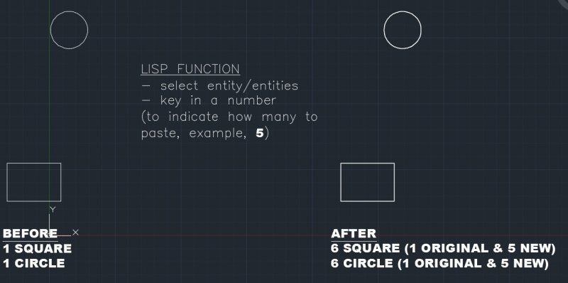

ctrlaltdel Posted September 26, 2016 Posted September 26, 2016 Any user here has lisp to copy an entity/entities & paste to the same location multiple times. lisp to run in this manner - select entity/entities - key in the number (to indicate how many to paste) - Enter (Please don't require user to click a base point) Quote
Tharwat Posted September 26, 2016 Posted September 26, 2016 I wonder what is the wisdom behind copying the same objects in the same original location many times? Quote
ctrlaltdel Posted September 26, 2016 Author Posted September 26, 2016 I wonder what is the wisdom behind copying the same objects in the same original location many times? Tharwat sir, the enity/entities are a reference item. I need to insert this reference item into various blocks in the same location. Therefore I need multiples of this enity/entities Quote
Tharwat Posted September 26, 2016 Posted September 26, 2016 Can you give a clear example of what you are after? Quote
ctrlaltdel Posted September 26, 2016 Author Posted September 26, 2016 Can you give a clear example of what you are after? Tharwat sir. Here is a photo & dwg file. I fogot to add in the photo, that preferable no base point input is required from user. Just paste the multiples on the top of the original. PASTE MULTIPLE FUNCTION.dwg Quote
Tharwat Posted September 26, 2016 Posted September 26, 2016 Try this; (defun c:Test (/ cm ss in) (if (and (setq ss (ssget "_:L")) (setq in (getint "\nSpecify number of copies :")) ) (progn (setq cm (getvar 'CMDECHO)) (setvar 'CMDECHO 0) (repeat in (command "_.COPY" ss "" '(0. 0.) '(0. 0.)) ) (setvar 'CMDECHO cm) ) ) (princ) ) Quote

ctrlaltdel Posted September 27, 2016 Author Posted September 27, 2016 Try this; (defun c:Test (/ cm ss in) (if (and (setq ss (ssget "_:L")) (setq in (getint "\nSpecify number of copies :")) ) (progn (setq cm (getvar 'CMDECHO)) (setvar 'CMDECHO 0) (repeat in (command "_.COPY" ss "" '(0. 0.) '(0. 0.)) ) (setvar 'CMDECHO cm) ) ) (princ) ) Tharwat sir. work as i wanted. Thanks so much. What is "_non" (2x) about. important? Quote

Tharwat Posted September 27, 2016 Posted September 27, 2016 Tharwat sir. work as i wanted. Thanks so much. You are welcome. What is "_non" (2x) about. important? Like the following adds and this should ignore the settings of your object snap settings to place the newly created objects in their correct place. (defun c:Test (/ cm ss in) (if (and (setq ss (ssget "_:L")) (setq in (getint "\nSpecify number of copies :")) ) (progn (setq cm (getvar 'CMDECHO)) (setvar 'CMDECHO 0) (repeat in (command "_.COPY" ss "" "_none" '(0. 0.) "_none" '(0. 0.)) ) (setvar 'CMDECHO cm) ) ) (princ) ) Quote

marko_ribar Posted September 27, 2016 Posted September 27, 2016 Another : (defun c:test ( / ss n i e ) (vl-load-com) (if (and (setq ss (ssget "_:L")) (not (initget 7)) (setq n (getint "\nHow many copies : ")) ) (repeat (setq i (sslength ss)) (setq e (ssname ss (setq i (1- i)))) (repeat n (vla-copy (vlax-ename->vla-object e)) ) ) ) (princ) ) Quote
ctrlaltdel Posted September 28, 2016 Author Posted September 28, 2016 Thanks marko_ribar. This works as well. Another : (defun c:test ( / ss n i e ) (vl-load-com) (if (and (setq ss (ssget "_:L")) (not (initget 7)) (setq n (getint "\nHow many copies : ")) ) (repeat (setq i (sslength ss)) (setq e (ssname ss (setq i (1- i)))) (repeat n (vla-copy (vlax-ename->vla-object e)) ) ) ) (princ) ) Quote
