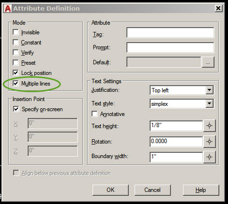

Add an attribute, or multiple attributes to the block, that is what I have setup for one of mine.
I simply meant to add an attribute to the block off to the side where your example shows Mtext. You can have a multiple line attribute, while in the attribute definition dialog box add a check mark to the Multiple Lines box on the Left side near the middle. Or add several lines of attributes one below the next.
