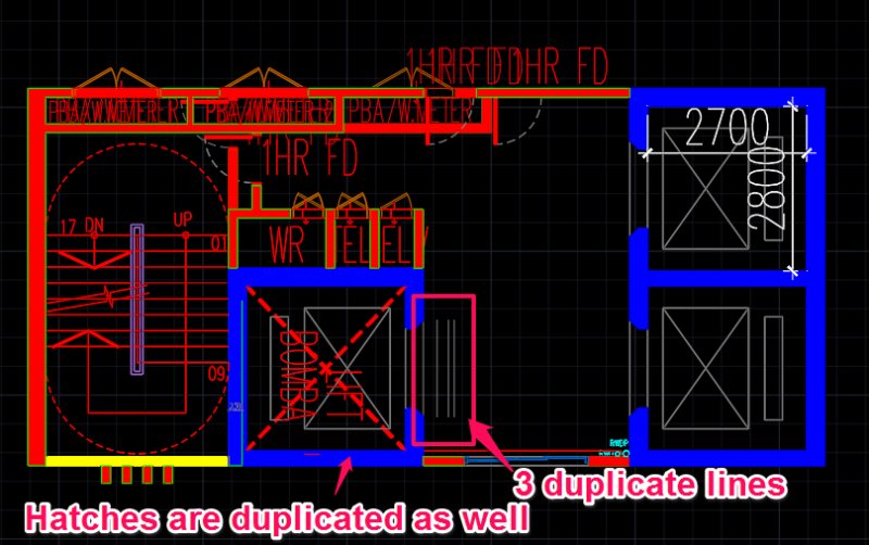

takeanosan Posted September 29, 2016 Posted September 29, 2016 (edited) So I've got one of my staff reporting that audit causes duplicate entities within blocks. Has anyone come across anything similar? Edited September 29, 2016 by takeanosan Duplicate entities within blocks only Quote
ReMark Posted September 29, 2016 Posted September 29, 2016 How did your staff member determine that the AUDIT command was causing duplicate entities in blocks in the first place? Doesn't the command check for errors in the drawing? Why would it create errors in a drawing instead? Quote
takeanosan Posted September 29, 2016 Author Posted September 29, 2016 Still trying to trace what was going on(Second time this was reported) The story was: She finished part of the drawing and used the audit command before going out for lunch. After coming back she continues to CAD for a while until she finds out that several of the blocks in the drawing has overlapped entities. (Quite obvious, doors are duplicated and flipped) She also mentioned that the duplicate entities tend to be those around the hatches / the hatches themselves. Some of the blocks have as much as 16 duplicates. :/ Besides that, this happens to the blocks that she has been editing before using audit. The blocks that have not been edited do not have duplicate entities. She suspects audit because she drew all the lines herself, and couldn't have messed up the blocks while drawing it. (would have been obvious) She reported that she saw around 5000+ errors audited, but after running audit on her messed up drawing I found 22 errors. I ruled out using the copy command and pressing multiple spaces because more than 1 duplicates are found. Also because this only happens within blocks. LISP is also ruled out because she is running AutoCAD LT 2016. If it was accidentally done to 1 block I'd understand, but this happened to multiple blocks in the drawing. I can't seem to think of any other other commands that could cause this as well. I've told her to save her drawing before doing any audits in the future, and I'll wait and see if this comes up again. Quote

takeanosan Posted September 29, 2016 Author Posted September 29, 2016 I've taken out major parts of the drawing, but this should be sufficient. After further inspection on the drawing I also found duplicate blocks. I'll ask her a bit more and investigate around tomorrow when she comes to work. It's already past office hour at the moment. I have yet to experience anything similar nor has any other CAD operator in the office. So far it has been unique to this drawing, whilst her CAD skill has been competent thus far. (>5 yrs experience) Going to try to copy the contents to a new drawing, either through Wblock or manually copying. http://expirebox.com/download/f5c8ee2dd10b825bb7e5d80a92995346.html Quote
ReMark Posted September 29, 2016 Posted September 29, 2016 (edited) Thanks for the drawing. Wish you had answered all my questions though. I think this will end up being a case of what I refer to as O.I.E. Operator Induced Error. I see xrefs were used. That could be one possible cause of the problems. What is the source of the drawing being xreffed? A quick run through using Overkill and -Purge (Regapps) and -Purge (All) reveals... -11 duplicate objects -145 overlapping objects Unreferenced objects including.... -18 Regapps (first time) + 2 additional Regapps (second time) -1 dimstyle -7 text styles -3 linetypes -31 layers -159 blocks Audit reported 114900 objects in two passes, 3334 blocks and it fixed 11 errors. It seems to me the drawing was not properly cleaned up. After running the WBLOCK command and comparing file sizes the original drawing was a little over 9MB in size. The new drawing is now down to a little over 1MB in size. Edited September 29, 2016 by ReMark Quote
