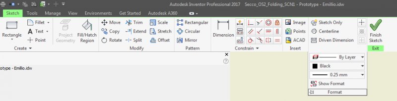

I am in drawing area.
I go to Manage>styles editor hitting to layer structure then setup layers there. All good...
Then you go to your title block or any sketch environment, select a line, under Sketch tab > Format you don't have Layer Name option to assign your selected object to a specific layer. You can almost change everything but the Layer, not only that it doesn't give you information the layer that selected object has been drawn! (see attached)
Basically, I want to assign a layer to a selected object in my sketch. Please help
Cheers
Ali
Instead of going to the Sketch tab, go to the Annotate tab and you will have the layer selection under the Format area. You can select existing visible lines and change them to hidden/border/custom from here. If you create a sketch on a view that is when that Sketch>Format area becomes useful.
