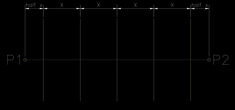

Hi all,
I am having some problems with my lisp routine code. The goal is to pick two points and have an xline generated perpendicular to the angle between points, positioned based on a few calculation within the function. I am, however, getting some wonky angles and no real consistency. Any thoughts?

Not sure about this, angle * 57.2958
(+ ang 90) Autocad will work angles often in radians so (+ ang (/ pi 2.0)) note the 2.0
(setq z2 (/ (/ (distance a b) y) 2.0)) to ensure real not integer answer just good house keeping.
I'm not sure why you are multiplying the angle, but the following should set you on the right path:
(defun c:aspacing ( / a b d )
   (and (setq a (getpoint "\n1st point: "))
        (setq b (getpoint "\n2nd point: " a))
        (setq d (distance a b))
        (entmake
            (list
               '(000 . "XLINE")
               '(100 . "AcDbEntity")
               '(100 . "AcDbXline")
                (cons 10 (trans (polar a (angle a b) (/ d (fix (1+ (/ d 4200.0))) 2.0)) 1 0))
                (cons 11 (trans (list (- (cadr a) (cadr b)) (- (car b) (car a))) 1 0 t))

Hey Bigal, thanks for the reply!
The * 57.2958 was to convert the radians to degrees, but now, if I understand correctly, I see that I don't need to as the other parts of the code deal in radians as well. Does (+ ang (/ pi 2.0)) add 90 degrees to the angle?
The 2.0 for real is a good tip, thanks. Just started getting into this kind of programming, and learning good practices is helpful. Thanks heaps!

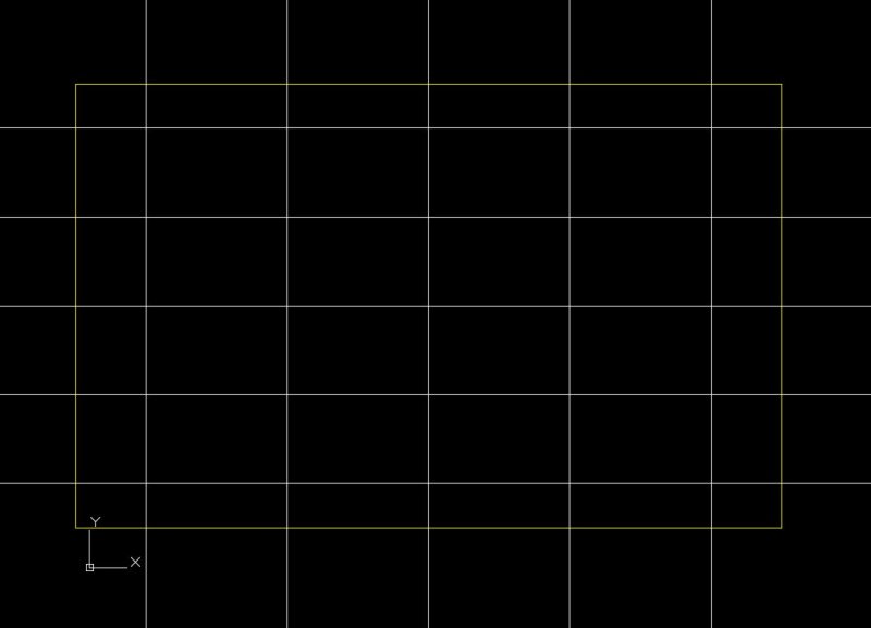

Continuing on from the actual functionality of the code - I want to add something to this command, but don't know how to go about it. I am hoping to have the first xline offset a number of times, so that the total number of xlines = the rounded up value of d/4200. The xlines need to have equal distance between them, but half that distance between the end lines and the two points chosen. Does that make sense?
Can this be achieved with something like a simple offset command (again, me not knowing a lot of basics, this is my only real thought) to be 2 x the distance from the first point to the second point?
I have more things I want to add, but baby steps at this stage. Thanks heaps!

Hi Bigal,
The structuring of your code seems similar to my initial post. It seems more straight forward (at least to me) following a one-after-another sort of approach. At least that's the way it appears to me. Thanks for your reply!
I have quite a large overall plan for this command. Attached below is an image of what I am trying to achieve for this part of the command.Capture.jpg
The xlines (supposed to be yellow in the image, not quite yellow) are the part that I want the command to draw, I don't need any of the dimensions, text, circles or grey line, just the xlines.
Does that make sense in regards to the previous posts? The number of xlines needs to be
if that makes sense. (the rounded up value of distance/4200)
Thanks for you help as well!
Maybe I should add what my plans are for the rest of the command.
I want the command to basically repeat itself a second time after the xlines are drawn, but in a different direction.
On the second run through, it needs to -
Get the distance between the two points of the second direction (value 0)
Get the distance between two of the existing xlines. (value 1)
Divide 12000 by value 1. (value 2)
Multiply value 2 by 1000 (value 3)
Divide value 0 by value 3 (value 4)
Round value 4 up to nearest whole number (value 5)
Use value 5 as the number of xlines to space in the second direction, keeping half x at the ends.
Basically, if I can repeat the command in a second direction, it will allow me to create a grid like in the image below, where the grid rectangles don't go over 12 square metres.
I hope this makes sense.
