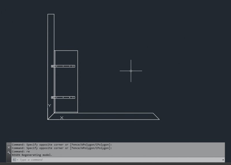

This is where I begin, with a plan view of some wireframe geometry, which I have isolated. Nothing crazy. You can see how I've moved the UCS to one of the corners of the wall:

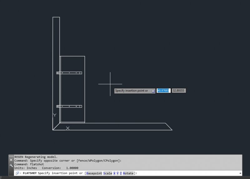

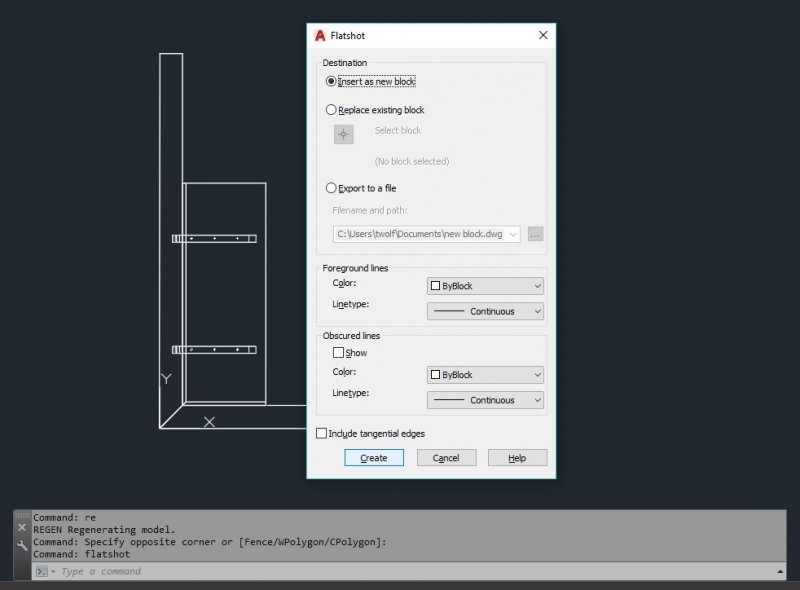

This is me starting the FLATSHOT command:
Command complete, awaiting insertion point. You can see how the new block is nowhere to be found:

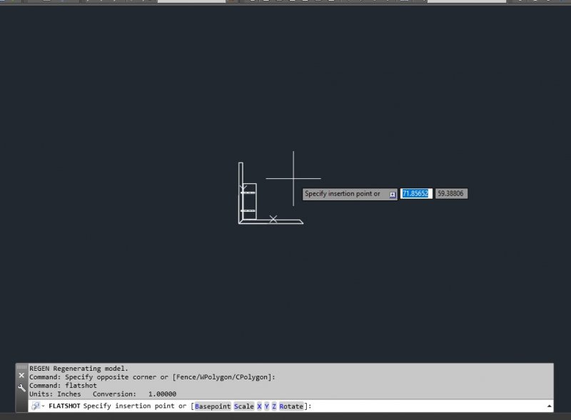

Because I used REGEN before I started FLATSHOT, I can only zoom out so far. The new block is still nowhere:

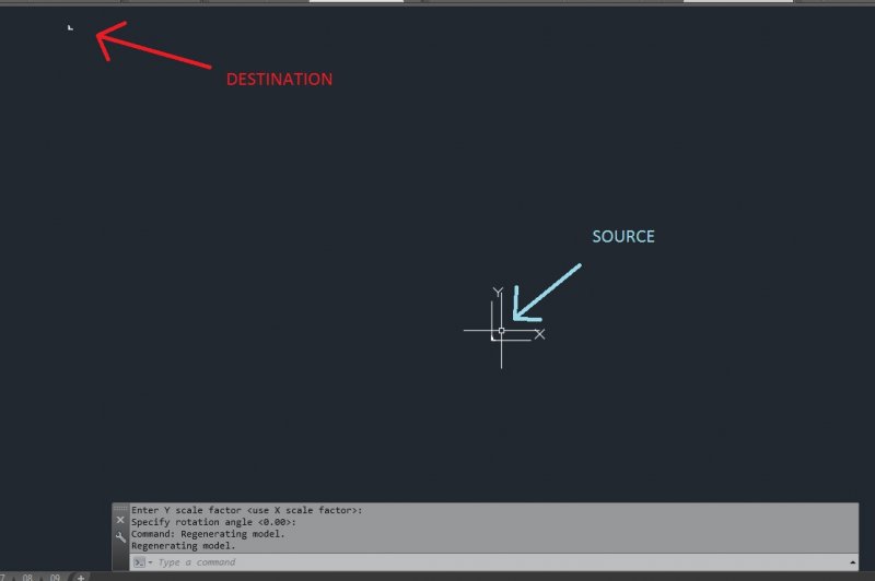

I had to place the block first, and then zoom wayyyy out to be able to find it. You can see how far away it ended up:
So... yeah. No idea why AUTOCAD would pick that point that far away from the crosshair. I have got to be missing something super simple.
I was doing some experimentation and maybe have a better answer for you. I was able to create the same scenario you were seeing and then fixed it with a command I didn't know existed, REGEN3. So make sure there are no objects a long way from your model and then run the REGEN3 command and then try again. See help for an explanation of that command.
Thanks rkent, the online help for REGEN3 is a little confusing so I'll have to toy with this for a while. It's a pretty weird issue, though, right?
