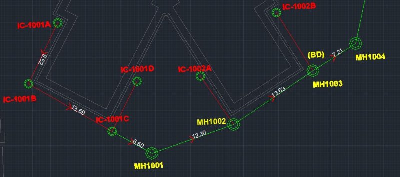

I have a series of lines connected from end to end. I want to do two things:
1) Place a text giving the length of the line on perpendicular bisector near the center of each line.
2) Insert a block (an arrow) at the center of each line aligned with the line.
I can do the second, but the first does't work with the following, what ever the angle I give in place of 0,
the block appears in the same original rotation.
;(setq plst1(list pt pt1 alfa dis))
;(setq plist(cons plst1 plist))
(defun draw1()
 (mapcar '(lambda(a) (command "_insert" "arrow" (car a) 1 1 0)) plist)
 (mapcar '(lambda(a) (command "_text" "_non"(car a) 0.6 (* (caddr a) 57.3) (rtos (cadddr a) 2 2))) plist)
Is there a way to solve this?.
Thanking in advance.
Aloy
Hi,
To align a block, we should know the rotation of the block.
If you can upload a sample drawing showing the result , that would be very helpful.
I would recommend looking into ( entmake ) the arrow INSERT

Thanks David & Tharwat for replying.
Modified the code a bit as follows:
(mapcar '(lambda(a) (entmake (list (cons 0 "INSERT") (cons 2 "ARROW") (cons 10 (car a)) (cons 50 (caddr a))))) plist)
Works perfectly. Here is a picture.
Glad it worked out. -David
