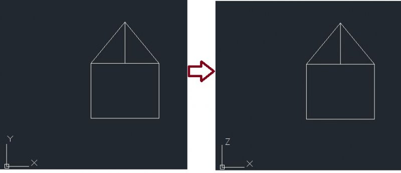

How to convert my drawings from X-Y to X-Z by Lisp? please help.
Use the _3DROTATE command. Or start a new dwg, flip the UCS and insert.
ROY,
thanks for reply. any lisp routine for quick operation (XY plane to XZ plane)? i have tried _3DROTATE. but not getting good results.
Thanks.
I prefer rotate3d to 3drotate.
Here are the prompts and response to go from XY to XZ.
Command: ROTATE3D
Current positive angle: ANGDIR=counterclockwise ANGBASE=0
Select objects: Specify opposite corner: 5 found
Select objects:
Specify first point on axis or define axis by
[Object/Last/View/Xaxis/Yaxis/Zaxis/2points]: x
Specify a point on the X axis :
Specify rotation angle or [Reference]: 90
~Lee
I rotate the UCS and then just use Rotate command.
I have never had a problem with rotate3d, one suggestion Specify a point on the X axis : pick the lower left point of your object
