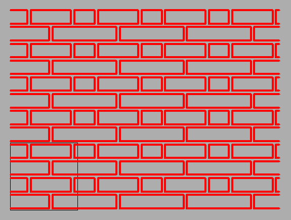

rock1 Posted October 26, 2016 Posted October 26, 2016 In trying to export my hatch pattern to Adobe Illustrator so that I can create a seamless pattern in the latter software. In order to do that, I make a square in Autocad, fill it with desired hatch pattern, and save the file. I open the dwg file in Illustrator, select the hatch fill and make a pattern out of it. But unfortunately, it is not seamless. This is due to the placement of my hatch in Autocad. How can I place my autocad hatch in the square so that I can easily export a seamless version in order to create a break free pattern in other software? Please don't advise any third party paid software for conversion. Quote

RobDraw Posted October 26, 2016 Posted October 26, 2016 I see two options. Make the pattern so that only full tiles and half tiles fit in the square. Make the square a size that only has full and half size tiles. In your example, look at the upper row and the right column. Eliminate the partial tiles by changing the scale of the pattern or the size of the square. Quote
rock1 Posted October 27, 2016 Author Posted October 27, 2016 When you made your hatch pattern originally in AutoCAD did you specify the origin point? See lower left hand corner of the Hatch dialog box where it says "Hatch origin". Yes, I did specify the origin point as the lower left vertex of the 1x1 square tile. I see two options. Make the pattern so that only full tiles and half tiles fit in the square. Make the square a size that only has full and half size tiles. In your example, look at the upper row and the right column. Eliminate the partial tiles by changing the scale of the pattern or the size of the square. I made a grid of 3x3 = 9 squares of 1 unit length of each square. Then I hatched with some patterns with scale set = 1. I got what I wanted without any alignment. The hatch automatically placed the full pattern in between and a quarter on each corner of the 1x1 square tile so that I can easily export it. Then I got some stone hatches, see the right portion of the image. If I set their scale = 1, I got very very dense fills. Then I set the scale to 0.07 and I got a visible stone hatch. I even set their origin to the bottom left vertex of the top left square in the 9x9 grid but did not get what I wanted Is there a smart way to force autocad to align the texture in the way that I want? I mean, an alignment just what you advised, full texture in the centre, and quarter portion of textures on every corner of the square tile. Quote

rock1 Posted October 27, 2016 Author Posted October 27, 2016 I'm able to get the brick texture tile. I am unable to get the gravel texture tile as illustrated in the last posted screenshot. One more thing. What is the use of setting the origin point? It just changes the location of the texture, that's it. What has "origin" as in the "starting point" has got to do with this option? I want to export the hatch tile unit to Adobe Illustrator and make it as a pattern within Illustrator (pattern fills) instead of full hatched area which behaves as just linework and makes illustrator files heavy. Quote
RobDraw Posted October 27, 2016 Posted October 27, 2016 I'm able to get the brick texture tile. I am unable to get the gravel texture tile as illustrated in the last posted screenshot. Again, you need to determine where the pattern starts repeating and set the scale so that length fits in the square or make the square fit the extent of the pattern before it starts repeating. Quote
