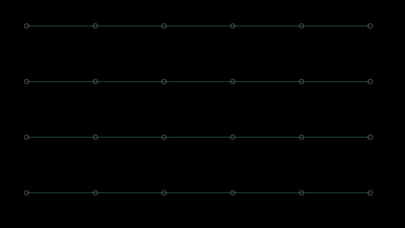

So, I now have the block in place (like so)

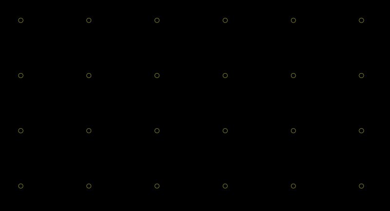

and I am wondering how to draw lines between the insertion points of those blocks. The insertion points are all aligned in a grid, with one edge of the grid longer than the other. However, the positions and quantities of these heads will differ in different situations. They will always be in a grid though. I am trying to draw lines connecting the blocks, in the direction of the longest length (like so)
My thought would be to get the insertion points (that your previous code helped me get), and draw lines from point to point, but I don't know how I could differentiate between points on different lines, and ending up with lines from every block to every other block.
It's a pretty specific outcome I am after. Thoughts on where I should start on this?
Since the code inserts blocks on intersection points isn't there already some sort of line grid in place?
Edited by Roy_043
I would suggest using the sorting method I implemented in this example - i.e. grouping by equal y-coordinate and sorting the group by x-coordinate.
Lee, you have more than 30k posts in both forums, how the heck you can find/remember a code that you posted from 5 years ago?!
Meticulous cataloguing of code examples & explanations to obviate wheel reinvention. ;) :P
Thanks for the replies all!
Good point Roy, I might firstly try doing something with the existing lines, perhaps trimming or something between the first and last blocks. That seems to me to be a tad bit simpler than Lee's suggested link.
Lee, thank you again for your suggestion, you've helped me out a few times over the past few weeks and I appreciate it! The link you posted will keep me going for a while, because I have to actually learn what half of it means! I may have questions in the future!
You are all winners in my book! Thanks heaps!
