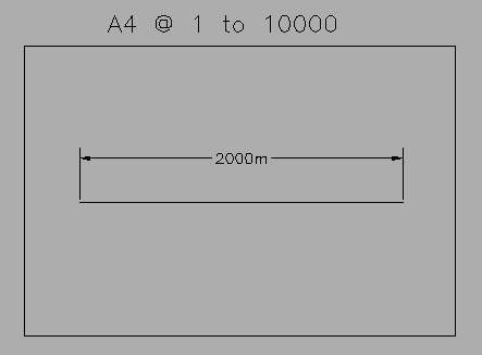

HI i have a drawing in meters with a size of 2 km and i want to fix him in a A4 paper in layout which scale should i chose and i worked on full scale 1:1 in the model

It shows the viewport scale of 0.115275 or can i make the drawing in millimeters by scaling them into 1000 and set the viewport scale
That scale is about 1:9, try setting the scale to 1:10, and center it in the viewport, however you want it to display. Once it looks ok, make sure you lock your viewport.
If you are working in metres, it is better to stay in metres and understand how the plotting works.
AutoCAD plots in millimetres, so you have to factor in this 1000 when you are using metres as a drawing scale.
The attached picture shows how an A4 at a scale of 1 to 10000 encompasses a 2km line.
If this is acceptable to you then the viewport scale is 1000/10000 = 0.1
