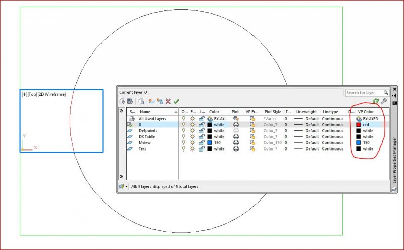

In my project have lot numbers of lines in different layer. I want change the color of particular layer...but not in entire drawing..only in particular section.
for example-:: select similar object in particular sectioned area then change the color.
My suggestion is not lisp based, but based on the fact that you can assign layers on the Viewport Layers Dialog to display differently than they do outside of that viewport, by using the VP Color option. In order to access this you need to be double clicked into a viewport, the colors of which you want to affect.
This approach would involve creating a viewport which would define the area inside of which you wish to alter the display color.

I will attach a screenshot representing the simplest case scenario. In the screenshot there are two viewports, one displays as blue, and the other displays green. The green viewport has been created by converting an Object into a viewport, which basically has an opening in it, inside of which the other viewport has been created. They both reference the same circle in modelspace, and the viewport scales are set the same, and both are locked. They are aligned in such a way that they almost appear as a single viewport, but in the smaller viewport's Layer Properties Dialog, there has been an alternate VP Color applied to Layer 0, upon which the circle is located. This means that in the larger viewport, the color displays as normal, and that in the smaller blue viewport, the layer color has been altered to display as red within the viewport, as indicated within the VP Color list on the screenshot.
That should give you the basic technique that can be used, although this is definitely the easiest case of how it might be done, the approach can be used in other more complex situations, and in fact, if you wanted to make some other layers display differently in that blue viewport you could do that too. Using this technique, you could create a number of different viewports, each of which could display differently at the same time. I hope that helps you.

Thank you so much for your kind information.
Now, I understood.
Thank You Dadgad.:D
