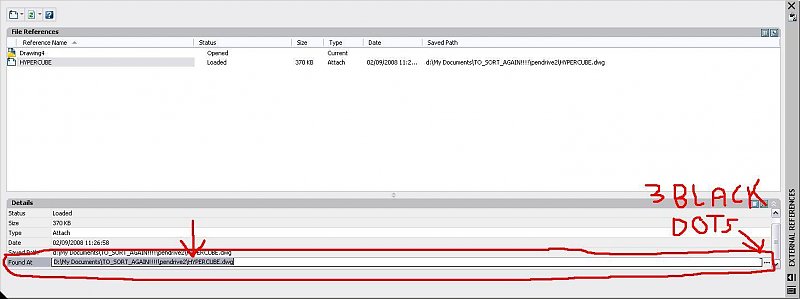

Are there any xref's in the drawing?
yes, but to tell you the truth- I don't really understand how xrefs work.
All an xref is, is another drawing that AutoCAD is "Looking" at and displaying on your drawing.
If you type xref, does the drawing/s listed show up as "Not Found" in the dialogue box?
there are around 8 that show up and they are labeled as:
open, not found, orphaned, unloaded

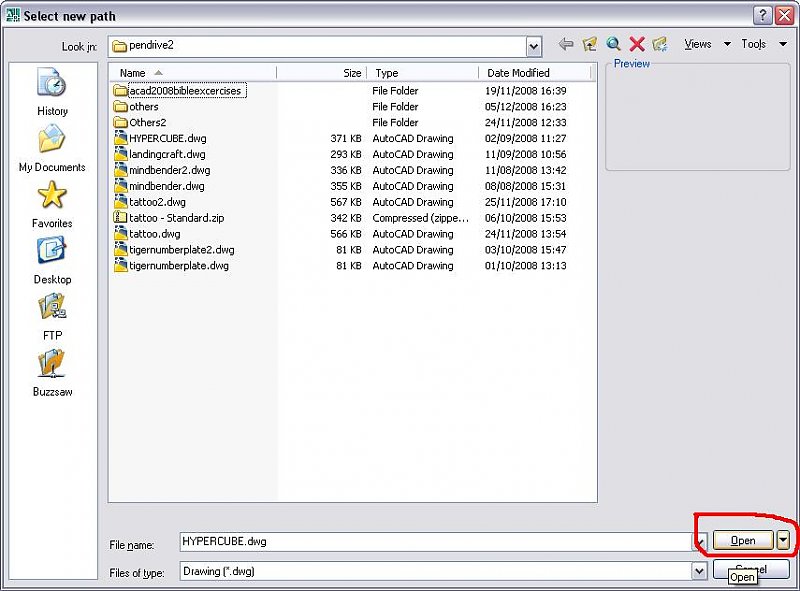

For each of the xref's try retelling AutoCAD where they are stored, click on one of the dwg's in the list (Not the current dwg tho)
And click in the "Found at" box, and then click on the 3 black dot's on the end of it, and go to where the othe drawing is saved, and click on it, then click on "open".
