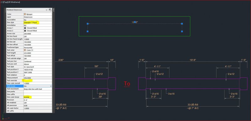

structo Posted November 30, 2016 Posted November 30, 2016 (edited) Hi friends, i have dimension text as 59" and so on. i want to convert as 4'-11"rule is above 18" dimension text should be convert as feet. any possibilities by quick lisp? Rule is: find text with inches(") symbol text and divided by "12". then replace with "Feet-Inch" text. like a 4'-11" instead of 59".( if more than 18" text value) Thank you. inches to feets.dwg Edited November 30, 2016 by structo Quote
Dadgad Posted November 30, 2016 Posted November 30, 2016 You could certainly do it with an ALTERNATE Dimension style, or by creating a brand new Dimension style. Quote
structo Posted November 30, 2016 Author Posted November 30, 2016 Hi friend, thank you for responding. yes i tried your idea already. but not success full. please observe sample drawing. there is one dimension style. in this style contains different text was included. please have a look. in this dimension style not a original dimension. there is edited text. so difficult to change each text. Thank you. Quote

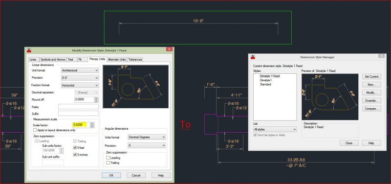

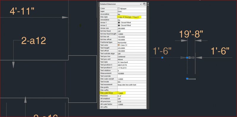

Dadgad Posted November 30, 2016 Posted November 30, 2016 (edited) You just need to set up the dimstyle to do what you want it to do. I have created a new dimstyle which I based upon the existing Dimsyle 1, and I adjusted the dimscale linear in the dimstyle definition, so that you would not need to OVERRIDE all your dimensions. I removed all of the OVERRIDES in the linework on the right, and selected all of the dimensions and changed their dimstyle in the QUICK PROPERTIES to Dimstyle 1 Fixed. I am not sure why you didn't draw this at 1:1 in Modelspace, as is the accepted industry norm. Typically working with Autocad one draws anything and everything, in Modelspace, at life size (1:1), unlike conventional drafting on a sheet of paper, where that very quickly becomes out of the question. If you SCALED this drawing by a factor of .02, everything would be the right size, in which case you would then be able to remove the .02 scale factor which I applied to the dimstyle as highlighted in yellow on the screenshot of the Quick Properties Tab. I just scaled the object in your drawing by a factor of .02, and adjusted the dimension style to reflect that change, as highlighted in yellow, the dim scale linear is no longer 0.02, but is now 1, as shown in the last screenshot. I hope this helps you. inches to feet.dwg Edited November 30, 2016 by Dadgad Quote
