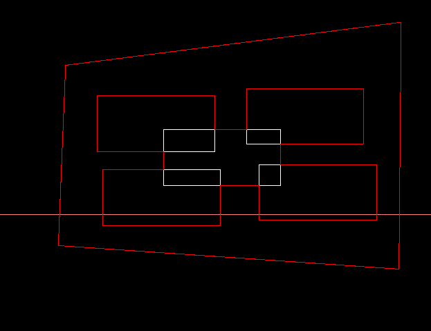

kashbg Posted December 1, 2016 Posted December 1, 2016 I have a floor layout drawing detailing multiple rooms that have been already polylined for area calculation. Is is possible to select the polylines of 6 or 7 rooms and create new polyline outlining the area of rooms. This may be also refereed as Shrinkwrap or ... Quote
ReMark Posted December 1, 2016 Posted December 1, 2016 There is no "Shrinkwrap" command in AutoCAD. I think you can accomplish what you want via the BOUNDARY command and a little bit of creative thinking. Someone asked a similar type question (creating an outline of a group of irregular shaped hatches) earlier this week. I'll see if I can locate the thread. OK....a link to thread. http://www.cadtutor.net/forum/showthread.php?99041-Merged-Hatch-Boundary-Problem&highlight=boundary My solution can be seen in post #8. Quote
tzframpton Posted December 1, 2016 Posted December 1, 2016 There is a Shrinkwrap command for AutoCAD Architecture. Is this what you mean by "Shrinkwrap"? See here: https://knowledge.autodesk.com/support/autocad-architecture/learn-explore/caas/CloudHelp/cloudhelp/2016/ENU/AutoCAD-Architecture/files/GUID-568FD1DC-C794-49DB-8127-E98804947D25-htm.html Quote
kashbg Posted December 2, 2016 Author Posted December 2, 2016 Hi ReMark, Thanks for your help. I had a go with the described by you method but it appears it only works on objects that are physically touching or overlapping each other. I am attaching a dwg that best describes what I am trying to achieve. There are multiple rooms polylined individually, converted to an individual block (not sure why) with area attributes. I would like to find out if I can select lets say 7 or 8 or the rooms and create one new polyline, outlining everything. In other words the new polyline would mark the Department boudary. The problem here is that the single room polylines are not touching each other neither overlap. Any ideas? Sample.dwg Quote
ReMark Posted December 2, 2016 Posted December 2, 2016 (edited) Yep, there has to be a monkey wrench in every problem. While my idea would work (with a slight tweak) in some areas in others it wouldn't work at all. I'm stumped. I believe I found what you are looking for. But I have not tested it on your particular problem. Funny though as I'm sure I checked Lee Mac's website when I was attempting to help out in the other thread I linked to above. OK....What you need to do is jump on over to Lee Mac's website and download/test his Outline Objects lisp routine. This is a link to his website. Note that in the program description he specifically mentions the word "shrinkwrap". How I missed this program before I have no idea. I hope it solves your problem. Report back with the result as I would be most interested in hearing. Good luck. http://www.lee-mac.com/outlineobjects.html Edited December 2, 2016 by ReMark Quote
kashbg Posted December 2, 2016 Author Posted December 2, 2016 Thanks ReMark, I will try your remedy and report back. Lee Mac's website keeps comming up regulary and indeed it is extremely usefull to all cad operators. Thanks for your assistance. Quote
kashbg Posted December 2, 2016 Author Posted December 2, 2016 Sorry ReMark, It did not work. This is no different to the boundary command. It outlines individual rooms/ closed polylines but not the total area. Any other sugestions? Quote
ReMark Posted December 2, 2016 Posted December 2, 2016 Yes. One. Download and install the 30-day trial version of AutoCAD Architecture. Of course this would assume that the Shrinkwrap command in the program would work given your special circumstances. The only other idea that comes to mind would be to hire a lisp guru to write a program specific to your needs. This is not something I see someone doing free of charge. Quote
kashbg Posted December 2, 2016 Author Posted December 2, 2016 Right, I guess there is no fix yet that anybody has needed. This drawing (attached) is produced by professional surveyor company. The area surveyed had been polylined and cataloged as per individual rooms/ polylines. Can anybody fugure out how they created the polylines (other than physically tracing) and why would they convert to individual blocks with attributes. There has got to be an easy way to automate this or method of doing this quickly. Has anybody come accross such work and if so can anybody describe to me the process of doing it. Thanks Sample 2.dwg Quote
ReMark Posted December 2, 2016 Posted December 2, 2016 Instead of wishing and hoping for an easy solution you should start looking into the two options I suggested previously unless time is of no concern. Quote

BIGAL Posted October 19, 2021 Posted October 19, 2021 (edited) Shrinkwrap is in some versions such as CIV3D but not plain Autocad. Maybe just draw a pline around objects then do BPOLY pick point inside it will hopefully make a new pline your boundary. Edited October 19, 2021 by BIGAL Quote
SLW210 Posted October 20, 2021 Posted October 20, 2021 Maybe this ................Merged Hatch Boundary Problem Quote
ReMark Posted October 20, 2021 Posted October 20, 2021 (edited) Take a look at this... SuperBoundary. https://superboundary.com/ Edited October 20, 2021 by ReMark Quote
