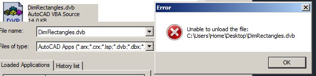

If this is the VBA ?
hi Marat,
thank you for your contribution. while loading your code showing error as attached image.
Thank you.
Is macro VBA
Run : Macro -> Load project -> DimRectangles.dvb

Is macro VBA
Excellent friend,:)
it is working.my request from your code is please add select rectangles option. because un wanted rectangle dimensions are developed. please add option for selecting.
