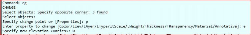

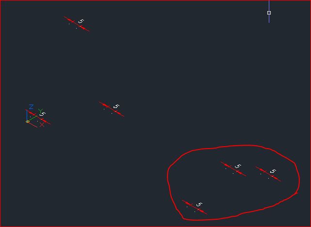

Hippe013 Posted December 5, 2016 Posted December 5, 2016 Does the OP want to bring the dimensions in their drawing to elevation zero? Quote
Dadgad Posted December 6, 2016 Posted December 6, 2016 (edited) You can do that using the CHANGE command, as shown in the screenshot of my commandline history. The dimensions on the left are at various elevations, before running the commands as shown in the commandline history snippet. Those circled in red, are the 3 dimensions which I selected when running the CHANGE command, after their PROPERTY, ELEVATION, has been CHANGED to ZERO. You might want to use the LAYISO command first, to isolate all of your dimensions, depending on your situation. In my commandline history, I use the shortcut "cg" to start the CHANGE command, but that is a custom Alias which I created. I believe the default is "-ch", or one can type CHANGE at the commandline. Edited December 6, 2016 by Dadgad Quote
wrha Posted December 7, 2016 Author Posted December 7, 2016 you can do that using the change command, as shown in the screenshot of my commandline history. The dimensions on the left are at various elevations, before running the commands as shown in the commandline history snippet. Those circled in red, are the 3 dimensions which i selected when running the change command, after their property, elevation, has been changed to zero. You might want to use the layiso command first, to isolate all of your dimensions, depending on your situation. In my commandline history, i use the shortcut "cg" to start the change command, but that is a custom alias which i created. I believe the default is "-ch", or one can type change at the commandline. its very good solution thank you very much . Sorry for delay on answer Quote
