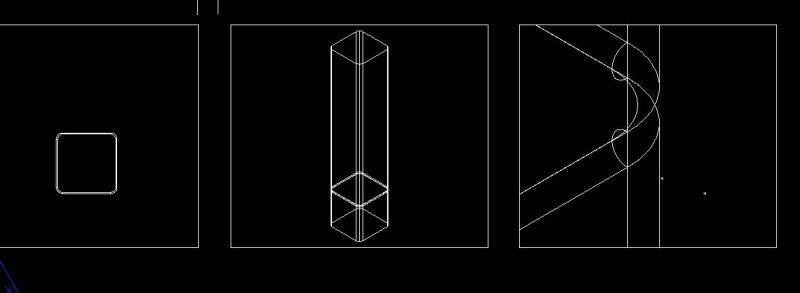

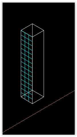

If you have a tube 4x4 lets say using Net hatch pattern with 1" squares would not the setting up of a ucs on each face not work ?
A 4x4 structural steel tube shape has radiused corners.
Remark yeah thought of that myself, also drew a 3x3 grid not 4x4 :lol:

Hi BIGAL
I am attaching some snap shots to explain the process - Please take a look
Regards
Adsk
