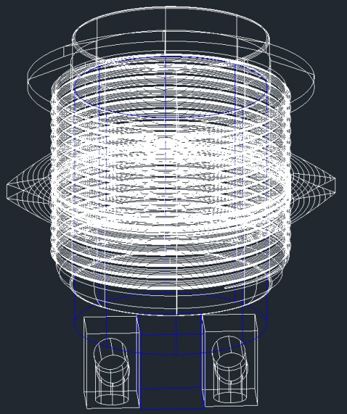

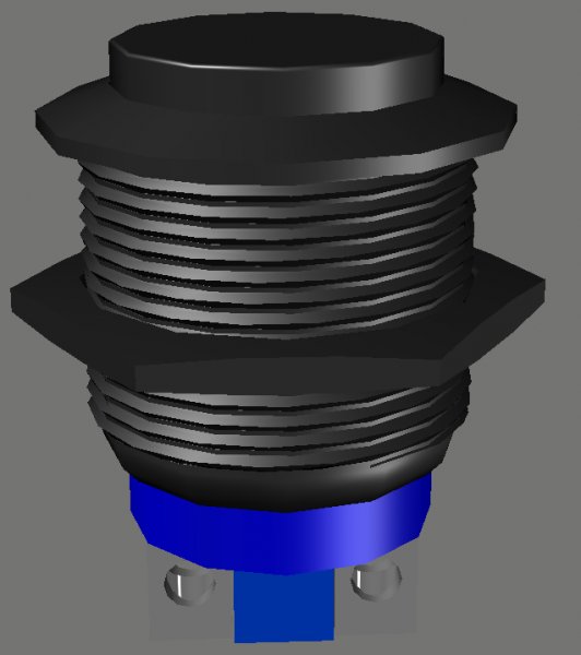

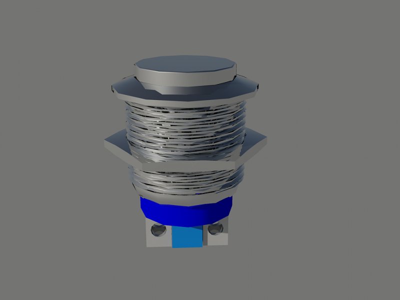

OMEGA-ThundeR Posted December 14, 2016 Posted December 14, 2016 Hi, I am making a 3D design of some button layout and recreated a button i want to use in AutoCAD. The problem i have when rendering is that the render result looks as 'choppy' as the modelspace model. Why aren't my round shapes round and do they have 'corners' and 'curves' in them? i use the 'presentation' preset under RPREF, but it still turns out as crappy as the model space... What am i doing wrong? Is it a setting i forgot? The wireframe render has perfect round objects, but it gets more 'squared' on more detailed shadings. Quote
Cad64 Posted December 15, 2016 Posted December 15, 2016 Try setting VIEWRES to 10,000 and FACETRES to 10. Quote
OMEGA-ThundeR Posted December 15, 2016 Author Posted December 15, 2016 Ok, i'll try that later tonight. However, as far as i can tell at my work this setting only changes the look in the modelspace. If i lower FACETRES round objects get more 'edgy', but in the render it still looks good. It might also be a difference in CAD version. At home i use 2015 and at work 2017... But i will find out tonight . Quote

SLW210 Posted December 16, 2016 Posted December 16, 2016 The problem is the button is too small, scale it up some and it looks correct. Quote
OMEGA-ThundeR Posted December 16, 2016 Author Posted December 16, 2016 Hot damn! My units are off or i need to size things up... tried to draw in Meters (so a lot of 0.00x sizes)... But indeed it seems to make everything smooth again when sizing it up... Thanks, this makes my day . Quote
