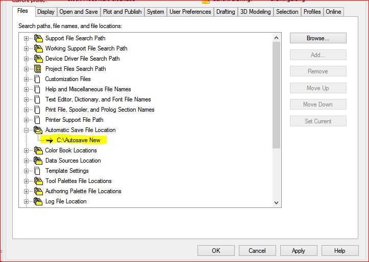

FIFTHTEXAS Posted January 10, 2017 Posted January 10, 2017 hi can anyone help. I have lost my back up files location in my folders, I am using windows 10 it not showing Autocad it gone to word for some reason. how can I get back to default. you right click on backup file, go properties, it gives options of apps to use to open file. where is back-up file location in Autocad folder. or is there other way regards Quote
Dadgad Posted January 10, 2017 Posted January 10, 2017 In Autocad, go into OPTIONS, and on the FILES tab, click on the Automatic Save File Location, to see where they are being saved. Quote
RobDraw Posted January 10, 2017 Posted January 10, 2017 By default, back-up files are stored in the same folder as the .dwg. You cannot open the .bak file directly. The file extension needs to be changed to .dwg. Quote

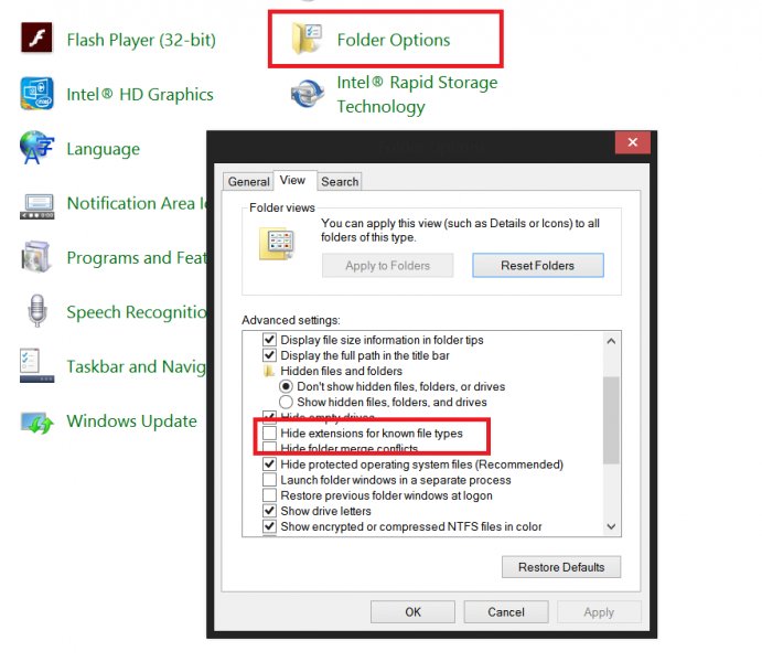

ReMark Posted January 10, 2017 Posted January 10, 2017 Will the .BAK file extension even be displayed in Win10 by default? Quote
welldriller Posted January 10, 2017 Posted January 10, 2017 Will the .BAK file extension even be displayed in Win10 by default? Hi ReMark; Not sure about Autocad now using Draftsight (free version) and it puts the back file by default. Lost my old AutocadLT 2000 when my daughter gave me a new computer. Quote
ReMark Posted January 10, 2017 Posted January 10, 2017 That wasn't what I was asking. Windows, by default, will not display certain file type extensions unless the user actively changes a particular Windows setting. The file types can spread across many different programs. Quote
BIGAL Posted January 11, 2017 Posted January 11, 2017 actively changes a particular Windows setting Maybe older win 7 etc "Hide extensions for known files types", have 10 at home will have a look for baks. Quote
Dana W Posted January 12, 2017 Posted January 12, 2017 This one? Control Panel > Folder Options > View Tab Quote
ReMark Posted January 12, 2017 Posted January 12, 2017 Yes, that is what I was referring to. Thanks Dana. Quote
