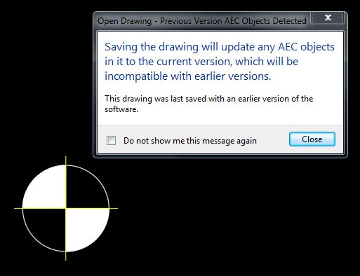

cpriedel Posted January 10, 2017 Posted January 10, 2017 I have a bit of a conundrum and I hope you can help... I am trying AutoCAD 2017 on my computer, before we are upgrading the rest of our seats (most work in 2016 some in 2014). 2 of our 2014 seats and 1 of or 2016 seat experience problems with inserting blocks into drawings. It just shows *invalid* in the command line. if I open up the same file on my computer in 2017 I can insert no problem! If I open the SAME file on my computer in 2016 I get the same *Invalid* prompt. Our current workaround is just copy and past as a block, but I want to get to the bottom of this. Any ideas, suggestions, theories? TIA Quote

ReMark Posted January 10, 2017 Posted January 10, 2017 Could this have anything to do with it? All I've done so far is open your original drawing. Quote
ReMark Posted January 10, 2017 Posted January 10, 2017 OK. Test done. I was able to insert your block into a new drawing in both AutoCAD 2015 and 2017. Are you using an AutoCAD vertical product by any chance? Ex. - Civil 3D. Try this one and let me know what happens. Reference Point Test.dwg Quote
cpriedel Posted January 10, 2017 Author Posted January 10, 2017 Thank ReMark. That totally worked! I will try it on one of the other seats to be sure We have our CAD setup to automatically down-save to 2010 (bosses request) What did you do? How did you get it to work? Is there a variable off somewhere? We are not using any vertical product, just plain ol' Autocad 2d Thanks for your help so far!!!! Quote
ReMark Posted January 10, 2017 Posted January 10, 2017 I purged the drawing (Regapps first, All second) then saved it. That's it. At no time did I use black magic....honest! Quote

BIGAL Posted January 11, 2017 Posted January 11, 2017 If you use WBLOCK from CIV3d it has an extra question about save MAP objects generally for this type of object say NO. If your using your CIV3D template to save the new blocks same thing AEC objects will be stored within the dwg even though not used. Do like Remark suggests and purge etc. Re problem so many depending drawings on your dwg directory structure it can take 5 minutes to make a script to convert 100+ dwgs etc, open purge save next etc You will be suprised how fast this happens converting dwg's. There is lots of shortcuts to create a list of dwg's and convert to a script as well as programs like scriptpro. Use excel or Word to create script. I am basing these comments on the fact that you will have a lott of your dwgs grouped in single directories and not scattered all over the place. Ask here and we can help. Time 0:0 CMD cd my blocks directory cd cars dir *.dwg >dircars.txt /b I now have a txt file with all my car blocks in it and modify it using word or excel to make a script open car1 -purge all * n save close . . . time 2:30 mins Quote
