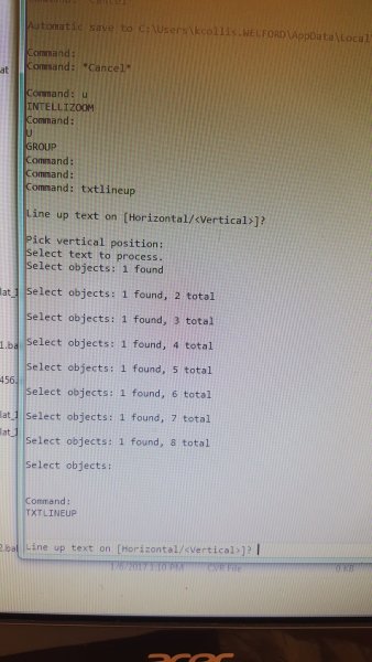

MillerMG Posted January 16, 2017 Author Posted January 16, 2017 Unfortunately, he does not have the TEXTALIGN command like we do. I tried that one out. I have attached a pic of his command line running the command that he has, TXTLINEUP. Quote
rkmcswain Posted January 16, 2017 Posted January 16, 2017 TXTLINEUP is a Carlson command. (It was my first guess after reading a command name like that...) Page 231. Quote
MillerMG Posted January 16, 2017 Author Posted January 16, 2017 Thats the same one that I took a pic of. This is the one you referred to in your first post. TXTLINEUP, from what he tells me, will not work. I don't think I explained it correctly. From your pic, the text lines up but thats only because they were already lined up vertically. If the text were spaced further apart, vertically, they would stay in their vertical positions when they are aligned horizontally. He wants them to align both vertically as well as horizontally. If you try to run a vertical alignment on the text from your picture, they just end up on top of one another. I'm thinking maybe Lee has a LISP that could replace TXTLINEUP? Quote
