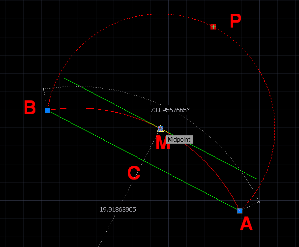

Maybe I don't understand, but it sounds like you are physically laying out a pattern on a grid, then trying to transfer that to an AutoCAD drawing. Also, it sounds like you are asking about measuring arcs in these physical patterns. Is that right? If so, then there may be some easier approaches to get it into AutoCAD.
If you can locate the endpoints of these arcs on the grid, draw a straight line between them, then determine the perpendicular distance from this line to the farthest point on the arc, you can determine its radius. Actually, you can just transfer the measurements into AutoCAD, and let AutoCAD determine the rest.
For example,
1. Draw a line connecting the endpoints (you don’t need nodes, just coordinates)
2. Offset this line the direction and distance you measured above
3. Start drawing an arc using Startpoint and Endpoint.
4. Finish the arc by just picking the midpoint of the offset line.
5. Now grab the midpoint of the arc and drag it to the midpoint of the offset line.
For more complicated curves, there are splines, etc., but, so far, it doesn’t sound like you need this.
There may be easier ways to do this, or better explanations, so don’t be afraid to ask.
Here is an example of what I was describing. The final arc should go through pts A, M & B. Determine point C on the physical pattern midway between A & B. Going from C perpendicular to AB will yield point M on the arc. You need to physically measure the distance from C to M, then use this as the offset distance from line AB in AutoCAD. In creating the initial arc in AutoCAD, the location of point P is not super-critical, but it is the midpoint of that initial arc. Grab this grip and drag it to point M, the midpoint on the offset line, and you should be done.
