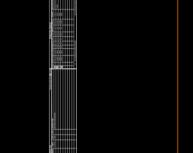

examples - orange is the edge of the PDF underlay.
squished.png[/url]

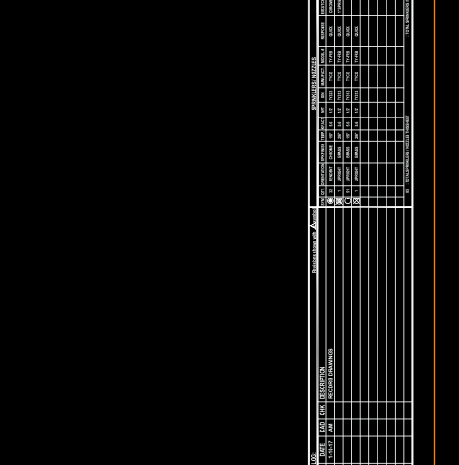

The next example is zoomed in one additional "click" and the PDF seems to show up fine.
unsquished.png[/url]
Sorry can't show the whole drawing.
