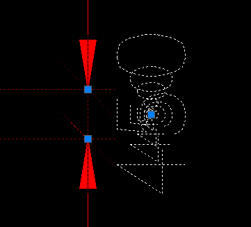

I have used annotative dimensions. After selecting dimension, dimension text will change as shown in image. How can I stop this ?
SELECTIONANNODISPLAY is the command. Remember you can type a few letters at the command line and then hit the tab key over and over until you get there.
No its OK. Thankyou verymuch for your help.
