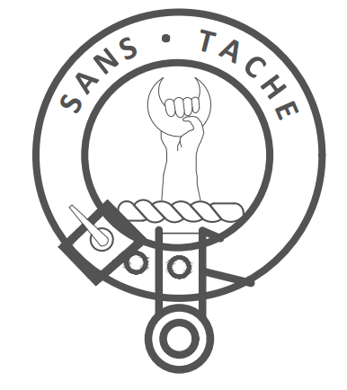

I am trying to re-create my family crest in AutoCAD. I was warned that this was a bit too advanced for a beginner, but I have everything done except the text. This is what the crest looks like:
How do I get that lettering in between the two circles? I am guessing I will have to do one letter at a time and then rotate them, but I have no idea how that is accomplished.

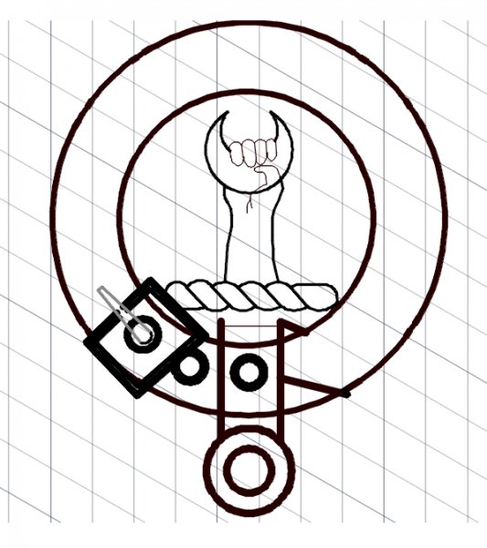

I am getting very close. Once I figure out this text thing I just need to clean up a few things and fill in some solid areas.
Not 100% complete, but I thank you for your assistance! Probably 15 more minutes of clean up and I will be ready to call it good.
